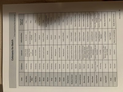

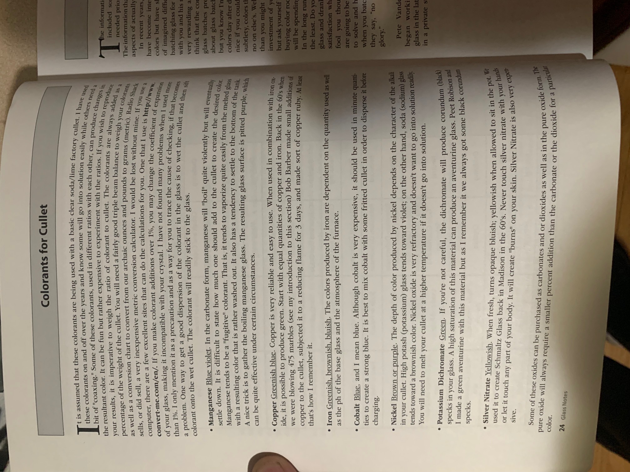

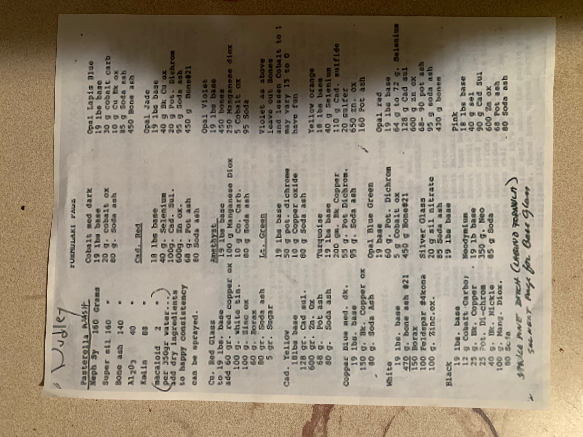

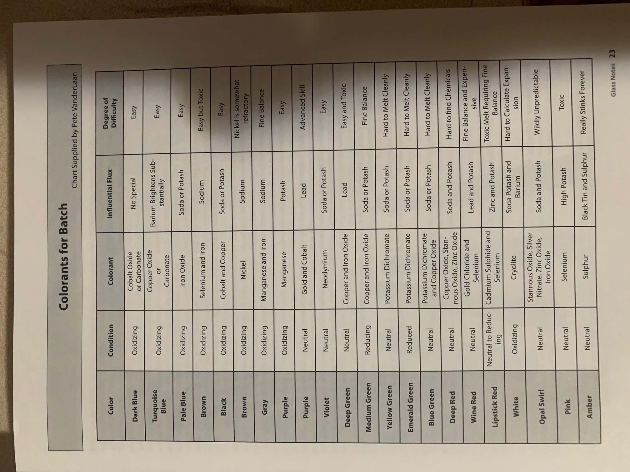

Here is some literature (attached). The book pages are from Glass Notes by Henry Halem and the recipes are in the public domain. I am posting the recipes so you can get an idea of how much colorant is added to a glass batch. Hopefully this will serve as a measure of potency. Another great book source is Coloured Glasses by W.A. Weyl.

Thank you Daniel. The batch colorant page is especially interesting. I need to access some small test amounts of some of the metal oxides (or carbonates) and I will probably give sulfur a run. At least I will find out with sulfur how well my vented enclosure works.
