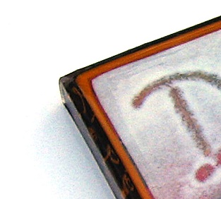

by Valerie Adams
I beveled the corners on some thicker pieces I made last year because my design elements needed to be seamless:

by Brock
Yeah, I've done that too. I'm talking about a horizontal overlap to join 2 flat pieces. Anyone done that?
