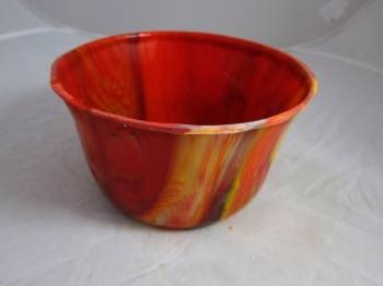

I'm in no way near accomplished as Cynthia. In fact this was my second melt and I decided to try "slumping deep" for the first time.
I still need to clean up the lip.. I'm still learning. I just wanted to say, there's a lot you can do with melts.

Posted: Thu Sep 26, 2013 5:45 am
by Havi
Very nice indeed.
What red did you use to acheive such beautiful red? They warn not to use red, as it becomes 'ugly brown'
Did you go as high as 1700 degrees? did you stay there, for how long??
Also , did you use the 3 molds to get to this deep bowl?, as instructed by Karl???
Or??
Thanks in advance,

Havi,
I'm very happy to help (finally) so many have helped me! I made a decision when I'm learning on my own to use 96 Coe as is cheaper. That was cherry opal from system 96, 30% and 20% yellow 50 clear. It was a pot melt and I did go to 1700 for 60 min.
As for the bowl, it was a drop out mold (donut) and I did it twice. The second time for 30 min until it hit the floor and then vented the kiln to 1150.
Hope that helps!!
