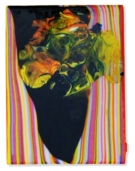

MY final goal is to fuse meshmelt piece into crakled piece which i had done separately previously.
1. Took a rectangular 3 m'm piece of fiber. Drew on it a triangle and sprinkled it with powder. Wet it as necessary, broke it, as necessary - in order to make the crackles. then put on top of it a rectangular piece of glass.
it Broke
Is it a thermal shock??
, but I followed the firing instructions... or is it because only part of the fiber paper was covered with powder?
In other words - next time if I want to repeat this procedure - should I do the powdered - would be crakled part separately, and then fuse it to the general background??
2. Upon cleaning the crackled face, I realised that actually it
could be fused like this. Of course cleaned and handled peoperly. And then, fuse the melt on top of it....
What do you think?
Have you got any advice / experience thatr you can share?
I'd be more than grateful.

The powder was not too thick, about 2 m'm, and your idea, Sharol must be right. I should have used transparent powder on the areas not meant to be covered with crackles. A bit hesitant, though, as I have bad experience, sometimes too much transparent powder becomes white. I'll have to think about it. A colleague of mine here suggested that the explosion was because of the dark color of the glass, he says I should have used clear transparent.
Yet, by now I was lucky to have 2 pieces where the 'melt' was properly fused into the glass. In one case it was full fuse, in the other it was tack fuse. Actually there is a third one which was conour fused [I should have stopped the process earlier, I was aiming at tack fuse, but this was really just an experiment]
The melt is 6 m'm thick. Those that worked for me were fused in a
very very conservative schedule 30 dph Celsius [54F] up to 540 Celsius [I'll translate it to farnheit later] [1004 F] .the whole firing took 40 hours....
and also I shall post photos of these.
Sharol, I LOVE a lot the process of melt, its organic developement and the fact that partially it works on its own will. I want to work more with this. I want also to try the other way round - to make a big melt, and then, deal with this as a background to some 'normal' fusing. There is still a long way to go...
