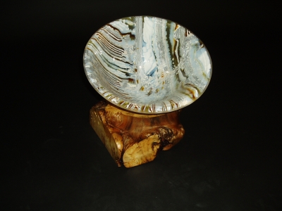

Re: Karl Harron 3 step mold
Posted: Wed Jul 10, 2013 2:14 pm
by twin vision glass
Glass Bowl with Wood Basejpeg.jpg (69.57 KiB) Viewed 17224 times
NOT a great photo but the vessel has a nice stretch to it.
