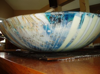

The bowl slumped nicely now off to the polisher to grind the edge . Not great photos but just thought you might like to see the finished piece.

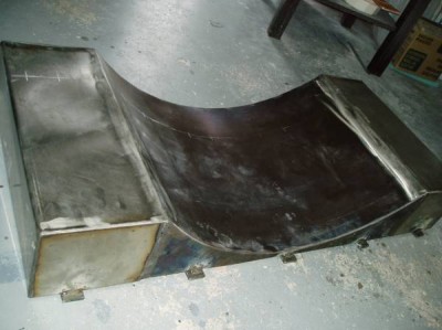

That would be wonderful , I will arrive on Thursday the 24th I believe and work hours to get the kiln ready for the flat fire ( and then large slump) on the 31st. So Monday would be super great. What do you think. Does that work. I will have to get the other kiln on by no later than the 31st so will have alittle time on the beginning of the week. Just call Uroboros and I am sure they will allow artists to come and say hi!!!! Look so forward to it. Here is my new slumping mold that I will be covering with a moldable ceramic material from Zircar Refractory Composites (experimenting so hope it all works ) Will allow the glass to have a cushion and air between the metal and glass is my thinking.
Mold is 50 inchs x 20 inchs x 8 inchs deep. Just enough room in Euclid Kiln but we will have to put bricks all the way around the outside to raise the roof up .
