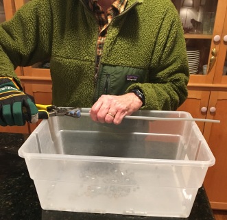

by Peter McCarthy
The choppers are relatively heavy, but I rest them on the bin I chop into, so I don't get fatigued.

by Kevin Midgley
From the photo, Peter is using those murrini cutters incorrectly in terms of arm positioning.
As this is a repetitive motion it is particularly risky behavior in terms of raising the risk of developing carpal tunnel.
If you design your set up to keep your elbows touching the sides of your body as well as support the weight of the tool, you will reduce the risk.
That set up could within an hour have my arms screaming in pain for days.
Strong hand squeezing motions using a heavy tool held at a distance from the body is a recipe for pain.
Elbows tucked in and touching the sides of your body is your 'power position' and key to avoiding it all.
