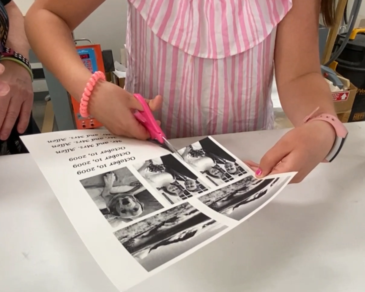

Photo Transfer (Decal) Paper
Photo Transfer Paper (also called Decal Paper) is used to create fusible decals from laser-printed artwork.
Either photographs or drawings can be used. Black and white artwork works best.
To use the paper you will need a laser printer that uses a black carbon-based toner cartridge.
