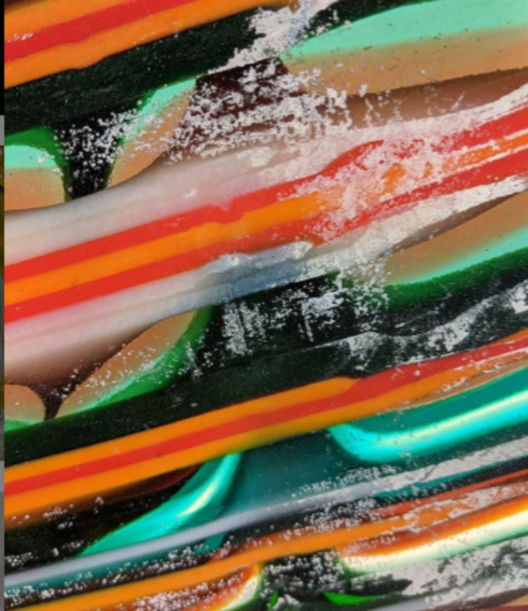

Warm Tip: How to Remove Stuck on Kiln Wash
Nothing is more frustrating than stuck on kiln wash! Here are a few methods that work to remove it.
1. Sandblasting – this is by far the easiest way.
2. Vinegar – Soaking the glass in distilled white vinegar (a mild acid) for two to three hours will often help the kiln wash come off with a minimum of scrubbing.
3. Wash Away- This is a great product that can be bought to remove kiln wash. Simply pour on glass, scrub with scouring pad, rinse.
